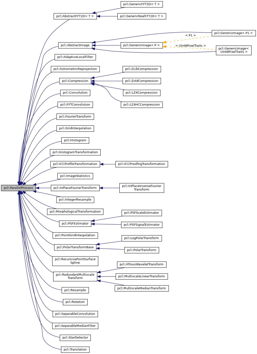

+ Inheritance diagram for pcl::ParallelProcess:
ParallelProcess is a base class for classes implementing multithreaded processes in PCL.
